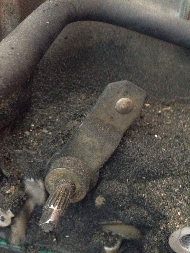

Ok...I got the switch off and left with the rod that goes into the transmission. Is this the part I clean? Do I take this rod part off also...How?
