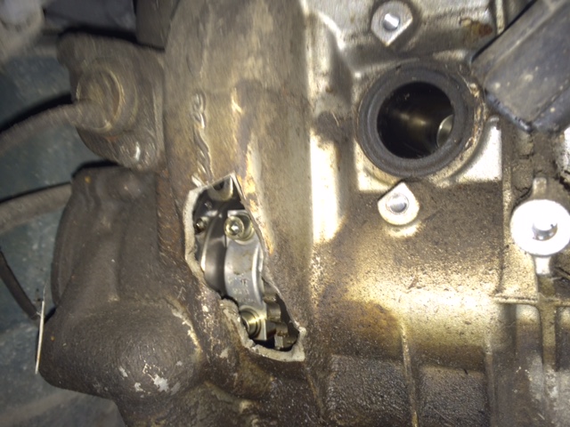

Sassmatt72 03-28-2015 07:53 AM
98 5spd, very very dead engine....
dropped the valve keepers, shattered the piston, cracked the liner...and the spark plug stripped out trying to remove it.
http://986forum.com/forums/uploads01...1427554358.jpg
http://986forum.com/forums/uploads01...1427554378.jpg
anyone got a good 2.5 long block for sale?

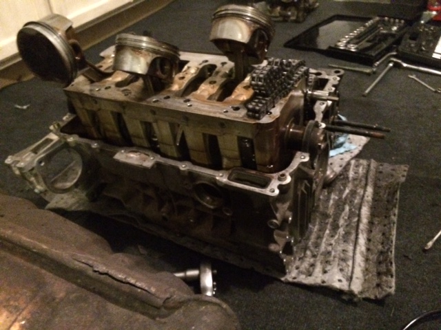

Bayley 05-04-2015 01:50 PM
2000 Boxster S with 58,000 dealership maintained miles at factory recommended service intervals.
Adult owned and never raced.
http://986forum.com/forums/uploads01...1430772599.jpg
Suddenly a great motor swap candidate. *Always look on the bright side.
