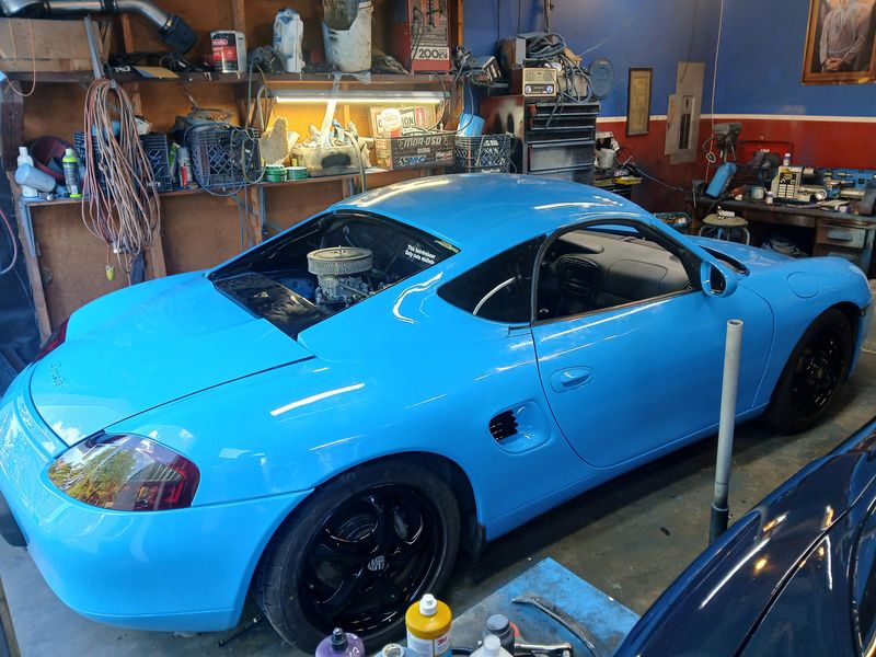

I cut out some breathing room in the engine bay. There is no reason to have sound deadening material now.
Oh did I mention I'm respraying the car to "Grabber Blue"?
'98 PP13B powered "RX986"

Now all the paint/body work is done... Engine sounds healthy. I was even able to switch to stage 1 plugs with the lower compression pistons. I might pick up some ponies from that move alone.
Now I just need a windscreen.

That took a while to get a windscreen... Apparently I have an antique car.
Paint is like a 10 footer in my eye. Plenty good enough for my purposes.
I did move to stock heat range TR5 plugs. I also was able to add a little timing into it too.
