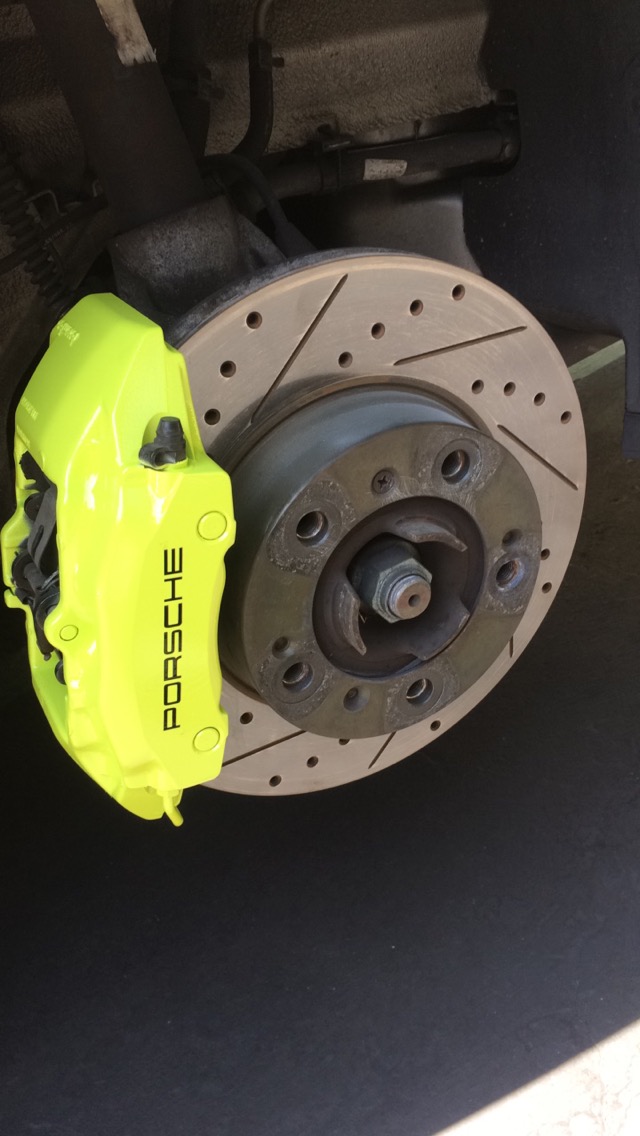

I just got these done and wanted to show them off to my fellow forum members.
Here are the steps that were followed.
Calipers were degreased and lightly sanded - then recleaned.
Primed with "White" high temp primer
3 Coats of paint
Lettering applied
1 Coat of Clear
Here are some pics of the work in progress.
It only cost me $150 plus tip!!!

[ATTACH]ATTACH]Here are more pics to provide you an idea of the work done - it took less than 2.5 hrs total!
I didn't even have to go to the shop the Service Tech came to me - I couldn't be more please with my choice.

Looks good. What did he charge and how did he get the caliper clean without disassemble?

I believe he used brake cleaner.
I high pressure washed them the day before and pre-treated them with Simple Green.
