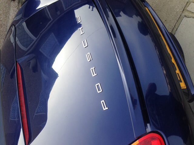

ensure you order the self adhesive ones! Initially I ended up with a set that had posts sticking out the back (which would mean drilling 2 holes per letter!)
First I cleaned the area with isoproponal alcohol

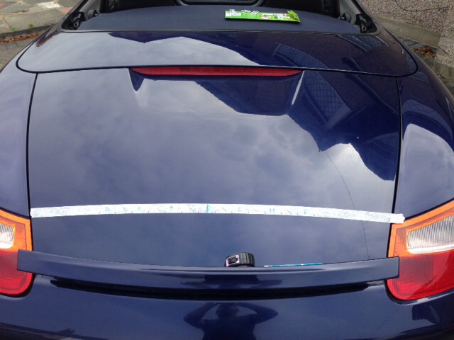

Pull some string across the boot lid. I used the pointy corners of the rear lights as a height guide.
Used masking tape to hold in position.
Measure and mark on the string the centre.
Take the S and position the top edge under the string, centred.
Then mark on the string 40mm either side of the left/right side of the S.
Place next letters.

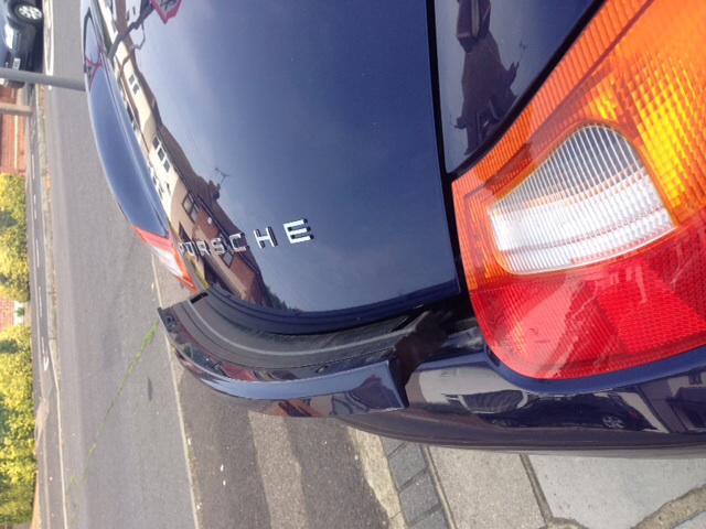

Basically the gap between letters I used was 40mm.

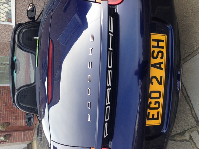

It looks cleaner if you remove the 'Boxster' badge - but I am lazy and don't mind the look with it left on.
Was a very easy job, and took less than 10 minutes.
