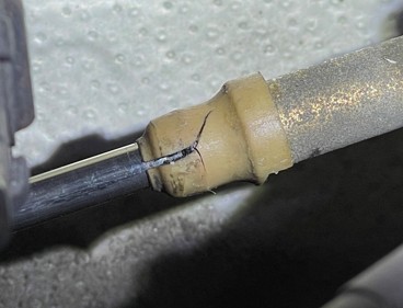

Update: Looks like the shift cable collar became dislodged from the sheathing and caused the cable to bind. Replacement is the only option.

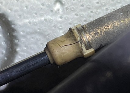

Yes, those cheap plastic wipers on the sheaths...
Here's how I found one of mine during the last maintenance day. I wrapped it tightly in vinyl electrical tape. Let's see how long that lasts.

Thanks for sharing!
By chance, are your cables original?
2001 Porsche Boxster S
bcrdukes is offline   Reply With Quote
Old 07-09-2025, 06:28 AM   #9
Join Date: Jan 2007
Location: BC
Posts: 1,357
Yes they are
