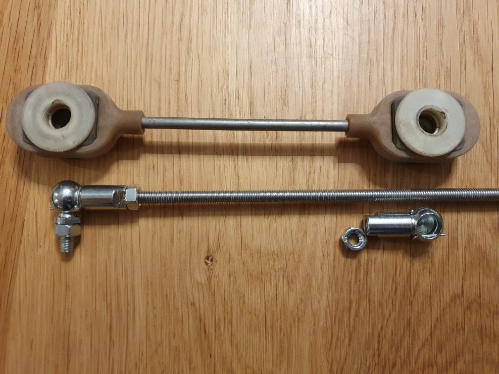

What did catch my eye though is that they have made part of the linkage similar to what I intend to do:
So replacing the rubbery stock part which does allow a lot of movement side to side with a solid part. Easy to make and try, and easy to swap back to stock if it does turn out to be too spartan. Seeing their part being so equal actually makes me confident of this improvement.

I'm not really worried about that as the cable ends are still rubber and allow a bit of 'give'. The G87/21 box I have is actually a Porsche version of the Audi 0A2 (which I also have, to go behind the audi V8 at a later stage). The audi linkage is much more solid, more comparable to the way BMW operates the gearboxes. If that is good enough in comfort and durability in an Audi, it should be good enough in a Porsche.
When I bought the car, the shift was extremely imprecise, it felt like shifting a lorry, aided by the ultra-stiff worn-to-bits clutch. It had more side to side play than the gates are apart. Main two culprits were the 986 shifter which was simply worn, side to side linkage as well as the bushings. The box itself was also very loose.
I like the idea of the feeler gauge / shim on the 987 shifter. Mind you, his first step was to move away from the 986 shifter if I'm not mistaken.
My rod for the linkage on the gearbox is done. I'll look at the fore-aft as well before I put it in. Fresh fluid is going in as I don't know the history of this box. It also needs a new reverse sensor as the connector suffered a hit. Will steal it from the 0A2 for now.
