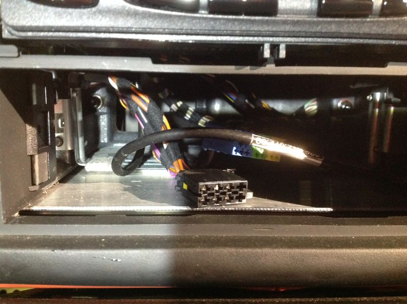

There is a spring loaded strip with a connector on the left side of the radio. If I recall correctly The left side trim panel harness carries the connecter and if you remove the horseshoe it comes off. You could've knocked it off and not put it back. I'm not sure this will result in your problem but it's worth a shot
You can see the strip on the left side of radio compartment. There is a connector that goes to it.
