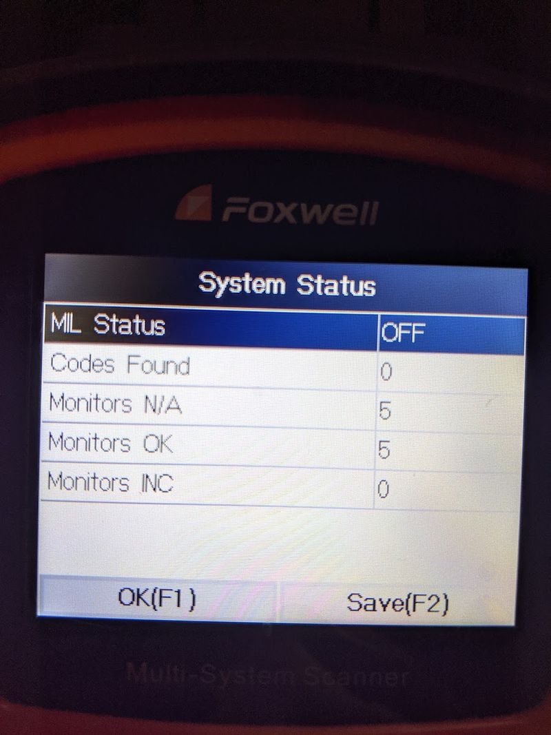

Now to the confusion: When I attach a scan tool the car shows less emissions monitors than I am used to seeing. There are only a total of 5 (all green). The tools I have all show it as passing the test, there are just less of them. I my attempts to research the oddity, all I get are hits for "Not ready" monitors, which is not my issue, all the ones I have, are ready and green.
I have 2 scantools, a general purpose innova 3100j+ and a Foxwell with the porsche software. Both show the same thing. The foxwell shows me the following screen in summary:
And then when i open the detail I see the following as OK:
Misfire Monitoring: Ok
Comprehenseve Component Monitoring: Ok
Evaporative System Monitoring: Ok
Secondary air System Monitoring: Ok
Oxygen sensor Monitoring: Ok
And these are all N/A
EGR system monitoring: N/A
Oxygen sensor heater monitoring: N/A
Heated Catalyst Monitoring: N/A
Fuel System Monitoring: N/A
The innova just have a green light to indicate it has no "not ready" monitors or engine light and green icons for the 5 monitors it sees. As a side note when I brought it in for NYS inspection it passed.

Sounds like a ROW tune. ROW tune turns off sensors to the rear O2's and secondary air injection. As far as I know the only way you can reprogram an ECU is with a PIWIS or PST.
