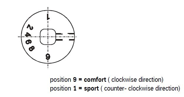

I've been running my PSS9 on setting 5 which is in the middle between comfort and sport:
Since Roebling is pretty smooth, I may adjust down to 3 and see how that feels. I've only driven them on setting 5 since I installed it (3 days at VIR, 4 days at Sebring, 1 day at The FIRM, and 2 days at Roebling) so I'm looking forward to seeing what (if any) measurable difference I can feel in moving from 5 to 3. I am scouring the various PSS9 settings threads to see what I can learn....
