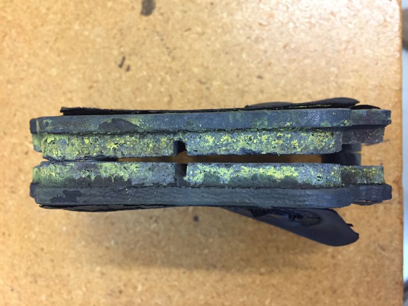

Here are a couple pics of the fronts.
Looks like the trailing edge is thinner in my case...
No noticeable difference between average thickness of inner and outer pad.
And yes... they are pretty cooked!

pad taper is common. Mine was much worse than yours. two different size pistons in the caliper are the likely cause. To increase life, flip the pads halfway through

I flip my pads too sometimes, also because in my case, it seems that the outers wear more than the inners, with my theory being that the inners are cooled more by the brake ducts?
After I rebuilt my calipers with new seals and boots, it "seemed" like the wear became more even, but I have nothing to back it up
