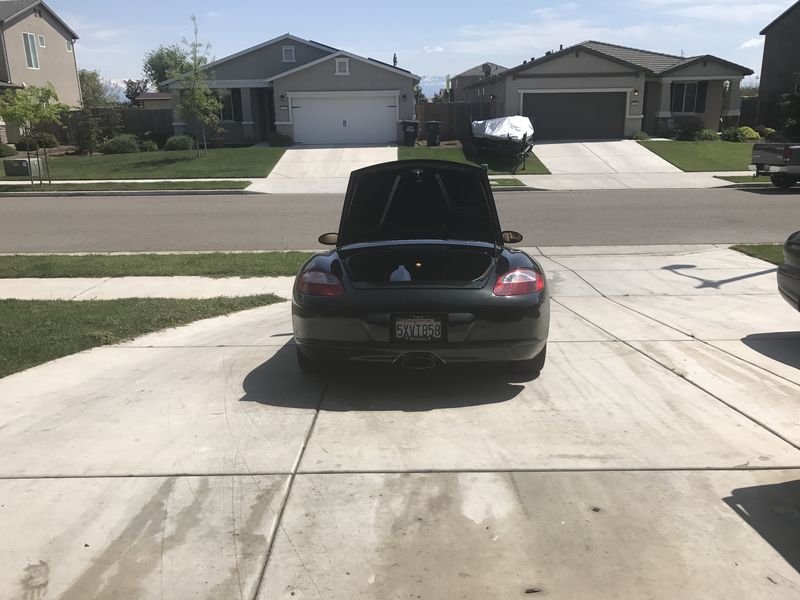

Ok everything seems ok burping in stages so not to leave car idle too long air bubbles coming out a lot of air bubbles.... temp stays normal at 175 ... went around the block temp was stable no noise no knocks drive smooth and like normal except no heat which leads me to believe there is a gnarled air pocket in heater core ... im burping at an angle ... in driveway gonna try to post pic to see if this is steep enough.... how long should this take? Any tips ? The dealer I work at is 50 miles away don't want to chance driving there for a tool ... may have to catch a ride to work tomm and bring the tool home I'm sure one of my Subaru techs have one

See my post 5 and read up Ahsai's coolant refill Posts. Until you use an Airlift you risk the same air pocket in the heater core.
If you elevate the rear higher and run the engine while monitoring everything you may burp it successfully according to others. But why take that risk ? A generic Airlift is $43 on FleaEBy.

Latest update did 30 mins of around town driving and everything worked this was after a huge air pocket surfaced and expelled from the over flow neck .... one more fill and drive tonight then that will decide if I drive or not ... the angle burp worked good ... I don't think my car is equipped with a burp valve since it's a 2007 ... but I will bring a gallon of coolant ... in case the air pocket shows itself ..... this has been an eye opening experience for sure next time I will be more prepared
