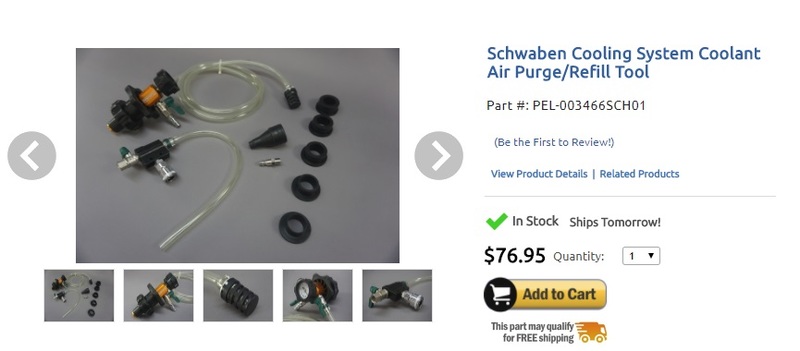

AZ986S 02-08-2018 03:09 PM
When adding coolant, you may want to use a coolant vacuum refill tool... like this one.
http://986forum.com/forums/uploads02...1518131315.jpg

+1 ...... I bought a similar unit for about $60 CDN when I replaced my left side radiator due to a small leak. Refill was simple using the vacuum system and I had zero issues.

Might just need to get me one of those! Always a good reason to buy a new tool, right?:cheers:
