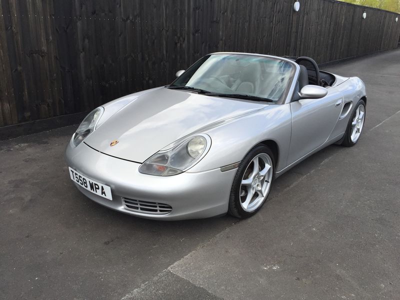

Just parked my 1999 boxster in the garage.
Purchased yesterday. Well proud.
Always loved the look of the boxster. Had a 911 but this is my first convertible Porsche.
