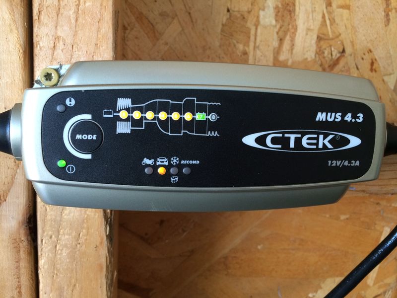

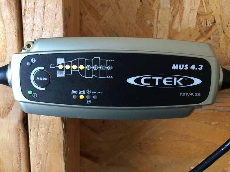

I have the retrofit HID lights that Fred created and have had issues "firing" them in the past. Last night I was driving as twilight came on. I was driving with the radio on and tried to turn on the headlights. The lights did not come on and the dash showed the battery icon. The spoiler raised (at 40 mph) and the radio began studdering. I turnd them off and tried again. No luck. I drove home without the lights but with the dash lights on. I pulled in and hooked my car to the battery tender. It registered 1, then 2 and 3 lights when I left it last night. I got up to 4 lights first thing this morning. Here is the pic.
This morning, it was still at 3 bars until around 8AM when it finally went to full charge.

Well I had a major issue tonight. I was out and tried to turn the headlights on. Nothing. It would flicker but the HID's would not fire. I turned the radio off and still nothing. I drove home with no lights and as soon as I put in in the garage, I plugged it in. 2 lights on the CTEK. It quickly went to 3 and is currently at 4.
So long story short, I cannot do that test right now.

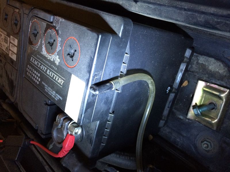

I pulled the current battery out. Here it is.
What is the tube coming out of the side in this picture?
Thanks again!

That is the vent tube. It vents hydrogen gas from the battery under the car instead of into the closed frunk.

Looking at that battery I'm guessing it's around 5 years old and so would be a good candidate for being bad. Don't like seeing the acid around the top plug on a maintenance free battery though.....
