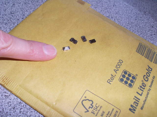

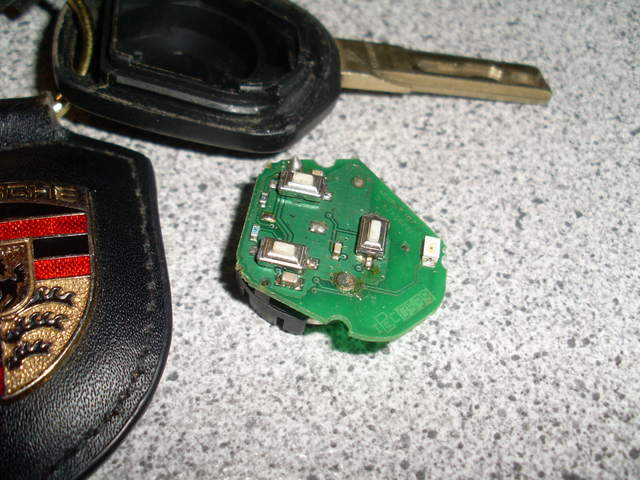

I had the same problem some time ago. I replaced the micro switches. Its ok now. I have posted some photos below.
These are the 3 old switches by one of the new ones.
New ones fitted.
This photo shows the red light on, it feels much more positive also and of course it locks and unlocks the car every time. Hope this helps you.
