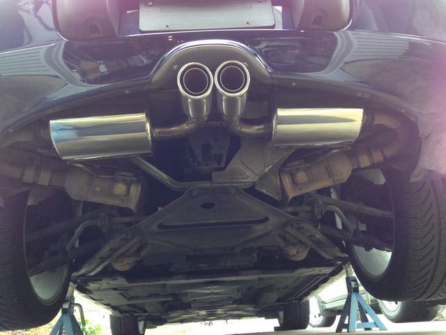

I sourced a set of US-spec M030 springs and put those on with the Konis. The car had the normal (not M030) suspension setup originally.
As for the exhaust setup, it's pretty much the popular, commonly available aftermarket dual mufflers setup along with the stock secondary cats and U-pipes. Here's a pic right after I polished the tips and mufflers:
