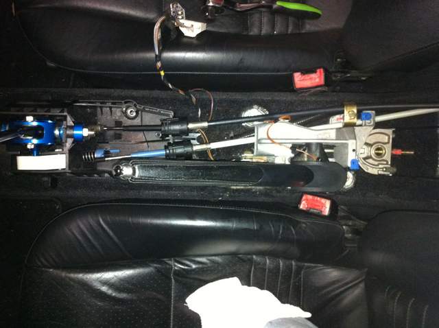

Does the right hand stock shifter cable location go under the hand brake frame and the bolted clip? I didn't get to see them coming out. Thanks!

it needs to seat under the "golden" bracket

Thank you .....thought as much. Another thing not done correctly

Ohhh did you need the back gold clip (near the fire wall) to get the console on?
How are the cables stacked in it? This maybe the source of my interference...very dark and cold here!!

Just a suggestion........spend the $20 to get a shifter alignment tool or it will take you forever to get it to shift correctly.

Yes...could have been easier. Do you have a part number?
It is shifting great but the console won't fit ......its pretty dark and cold but it looks like the firewall clip is not doing what it should...or it's shape is off. The cables maybe coming in at too gradual a slope preventing it from sitting down at the back
