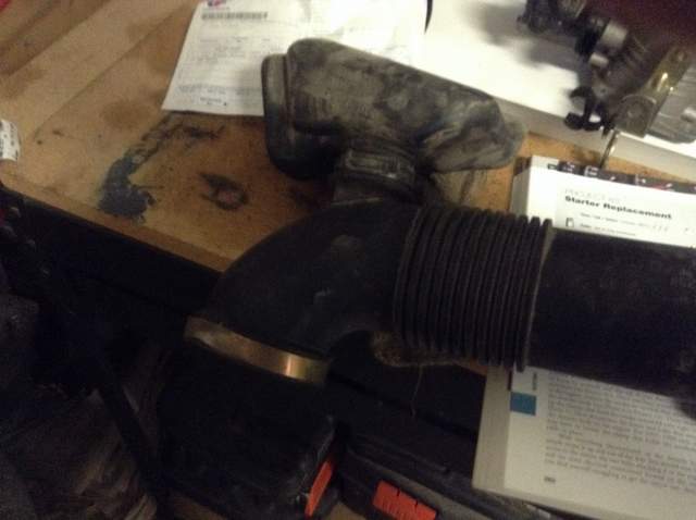

A major fun part was removing the inlet tube with this gawdawful bladder attached to and shoved underneath the motor opening. (Picture 1) what is this growth and is it necessary?

As for the bladder attached to the intake tube. I deleted mine and plugged the hole. Just make sure it is sealed, no leaks. Not sure what Porsche's angle was with this muffler - sound or backfire protection who know. It is a pain to deal with.

The bladder is part of your tuned intake called the Helmholz resonator. It has two purposes. One is to cancel acoustic waves from the intake valves that travel up the intake and can foul your MAF sensor readings. The other is simply intake noise suppression.
