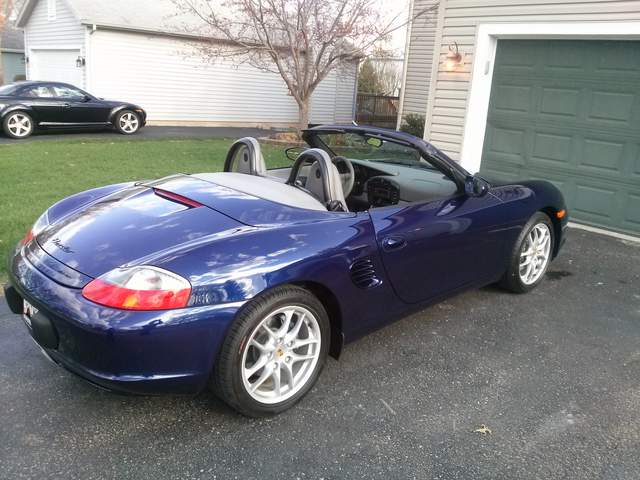

I bit the bullet and bought an ebay muffler. I got the job done in about 2 hours. I have never done any exhaust work and i was able to do this job. Keep in mind my boxster only has 3000 miles so no rust frozen or broken parts.
The muffler says beluga racing however it looks just like the rest of the ebay muffs and it was $255 free shipping. It was a direct replacement and reused the stock clamps. It bolted up ok and is driveable, however the tips arent centered. Im going to have to take a bar to em. They dont hang out past the bumper anymore than the stock tip did.
The sound is much more aggressive than stock however is still quite tame. It definitly growls. I think it has what you all call "drone" a deep somewhat vibration growl at around 2500 rpms, however its not unbarable and i typically dont drive much at that speed.
