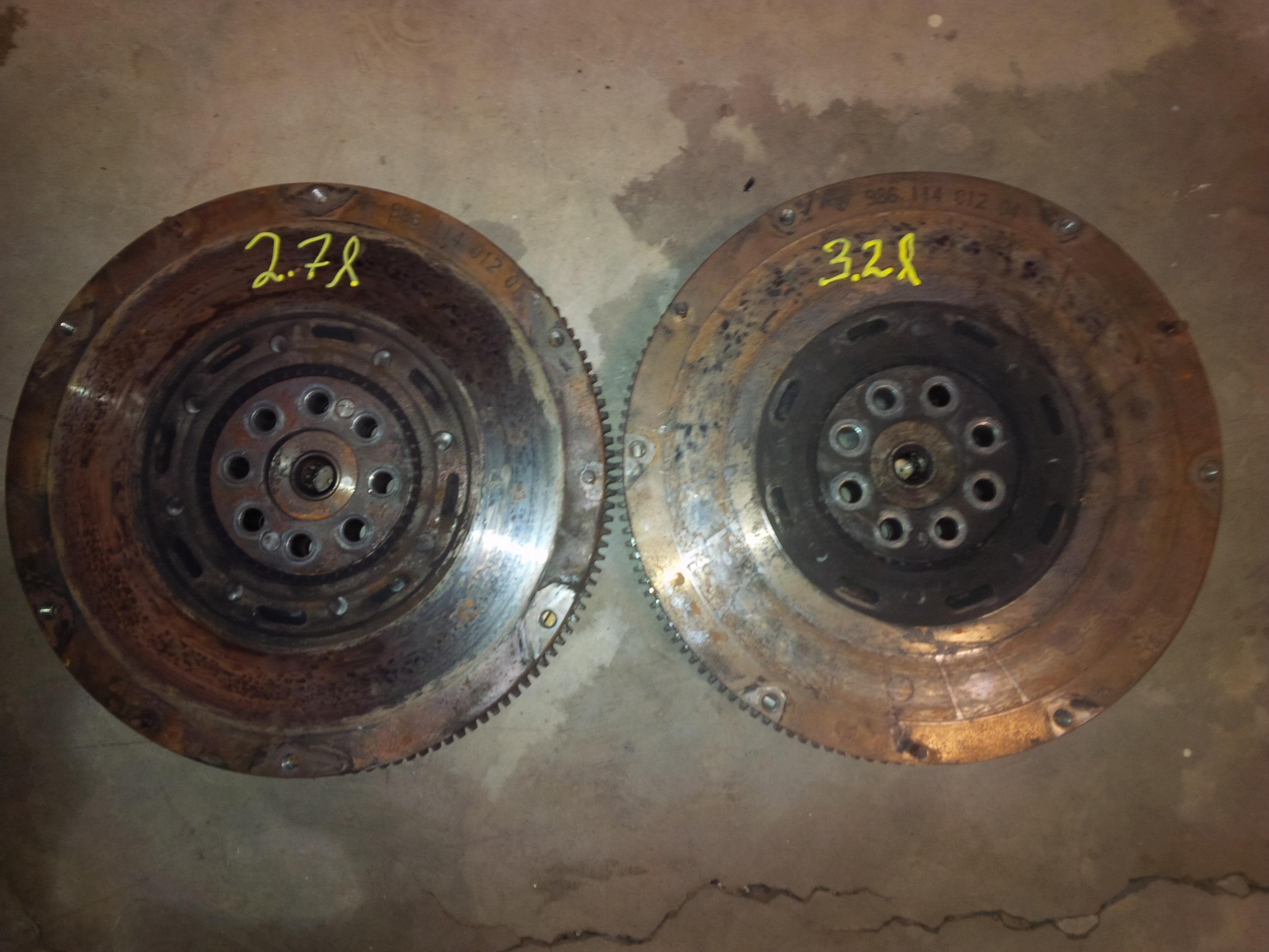

To help with this "investigation", I have put both flywheels side by side and see no difference. I have pictures, but have no idea how to attach them here. PM me if you'd like to see them or can help post them.

Here are the pictures of the 2.7 VS 3.2 Flywheel. I'm just going to go for it and mount the 6 speed clutch and transmission to the 2.7 Flywheel, I cannot see a reason this won't work.
