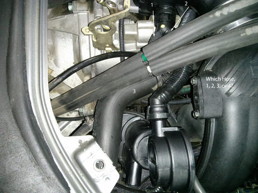

2) Oil on top of engine (Cleaned engine and watching for oil) (check AOS hose? -- which one?)

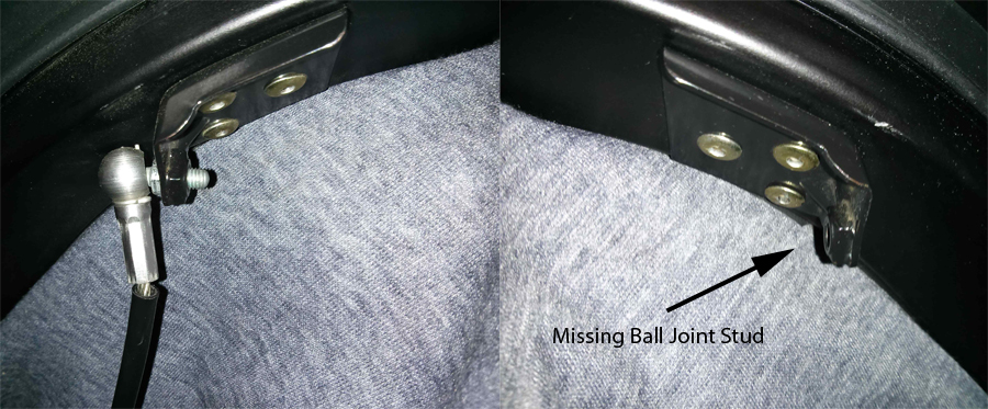

6) Passenger side top ball joint stud missing (? order from Denmark?)

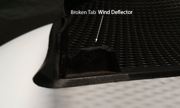

7) How to remove windstop? (someone local must know?)

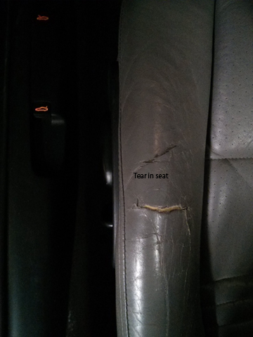

9) Driver seat tear (replace just the torn parts?)

11) Fabric clip broken (what does this fabric fence do?)

2. You probably have P/S fluid on top of engine from the short vent hose. Extend the hose to below the engine. Top up P/S fluid with Pentosion. I answered your other thread.

4,5,6,7. Never had any top problems,so don't know.

9,10. Go to best Upholstery shop in town.
11. the fabric helps guide the top & keeps foreign objects out of hinges.

To remove the windstop, gently lift the little levers toward the middle of the car and pull the corner of the plastic toward the rear of the car. Repeat on other side. It's difficult until you see it work. PM me if you still can't get it off and we can talk on the phone or meet. DON'T force it or you Lloyd break 8ff the levers and then you're hosed.
The mesh wind blocks don't absolutely need all the tabs -- just secure them to the roll bar with a black 8-inch zip tie or two.

...The mesh wind blocks don't absolutely need all the tabs -- just secure them to the roll bar with a black 8-inch zip tie or two.
Black electrical tape to role bar all around ID perimeter may look tidy as well.
