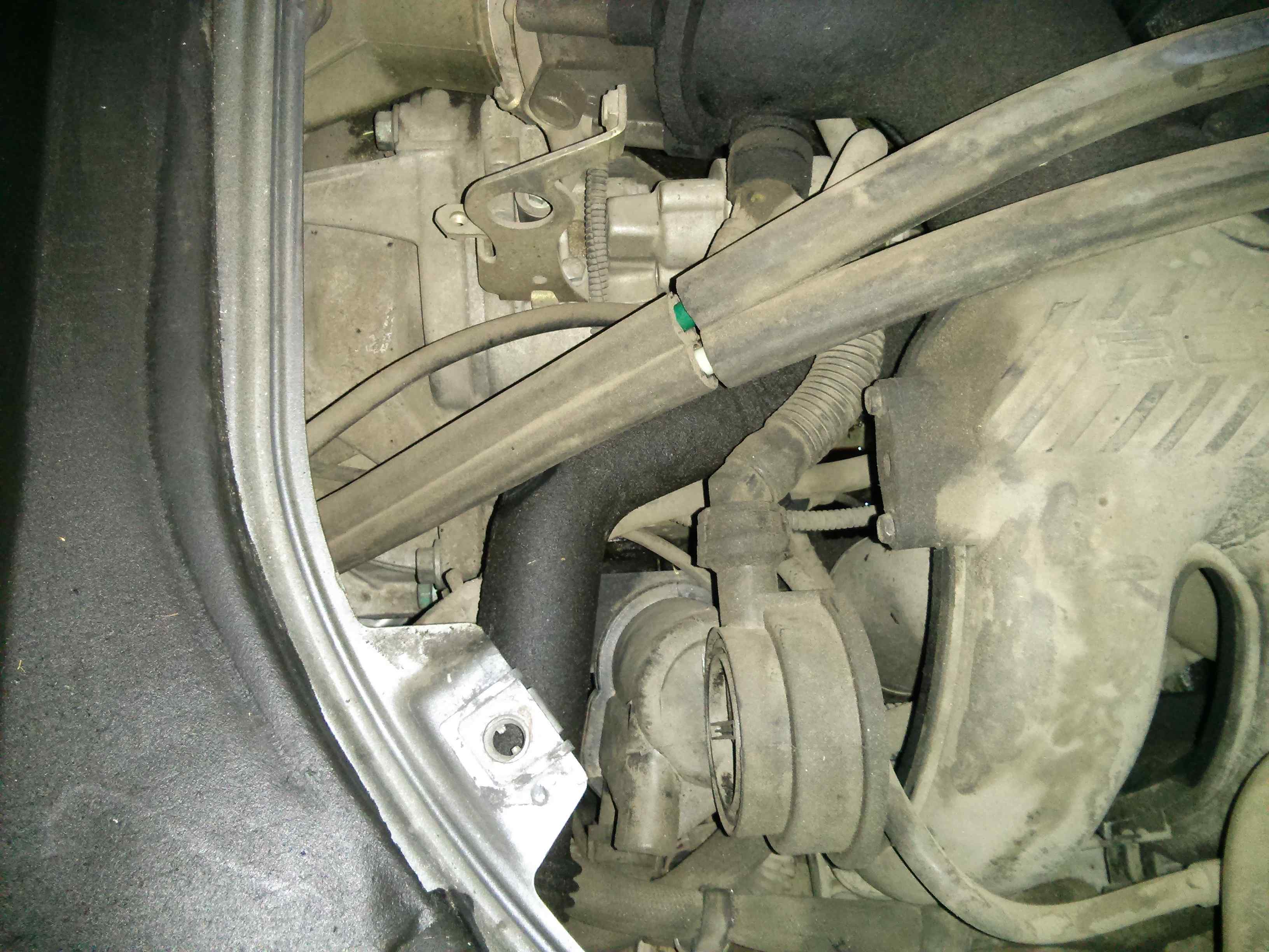

Which hose?
The attached image has the AOS hoses shown. Which hose am I supposed to check; 1, 2, 3, or 4? Thanks

#4 that goes to the intake manifold

Pull 1&2 where they merge into the intake manifold & swab around the inside with your finger for oil etc.
Also check the pleated hose under the AOS for leaks & tears. It looks like a accordian & is clamped to the engine head.
