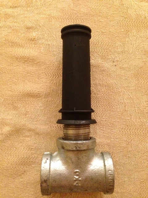

Here's a couple of pictures. If you look closely at the first one you will see th threaded pipe is tapered. So it fits in the tube about half way before the threads engage. The theory is you just srew it in and then pull it out and the tube comes out easily. The transom sometimes does not expand enough sometimes or starts to break under the stress. if I recall correcly, the pipe is standard 3/4" fittings.
T-Section
T-Section in Spark Plug Tube

Posts: 2,668
Ahhh tapered thread!
I wonder why no one has come up with a simple hook tool to catch the bottom lip and pull the tube in one fell swoop....

Because when the tubes get old and brittle (a bit like me) the "hook tool" can break the tube and the bits finish up in the cambox.....

Good point very true .....was thinking a half moon shape elipse but even that may do damage
