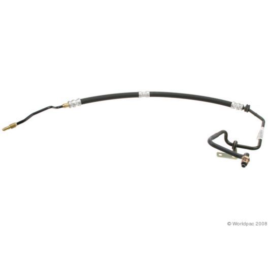

Driving today and suddenly see white smoke and pull over. Initially think engine oil. Get towed home, start the car and theres no power steering. Seems it was the ps fluid that was pouring out. Good news it wasnt the engine oil.
I think it may be the of the ps hoses under the left side of the car by the engine And suggestions on how to diagnose where the leak is? Any advice on replacing a ps hose? And advice on anything to do with ps.

If you have nonstock exhaust manifolds check to see if the hose is burned thru on the header. I would refill the pump & test it 1st before disassembling anything so you know if the pump is still good.
If it's the hose that conects to the rear of the pump & runs down the side of the head I have a good extra hose.

Just read both replies and I can confirm that you are both correct. I found the hose was resting against the headers and there was the leak.

That's a great price. Thanks! Can you confirm that its the hose in the picture I posted? You posted "if its the hose that connects to the rear of the pump."
Would you ship it to San Diego?

It is the pressure hose like in your picture that actually threads into the front, pulley side of the pump. I have a pump too, do you want to test yours after filling with Pentosion before I ship the hose Monday? PM me.
