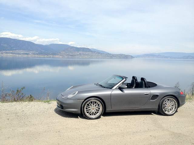

Here is the picture of my car now named the Brokster as its taking all my money.
