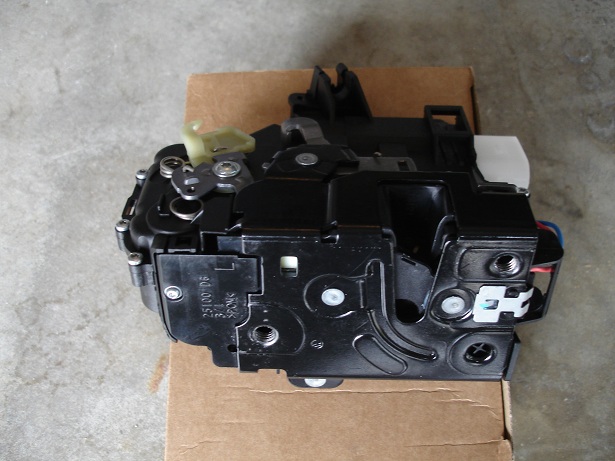

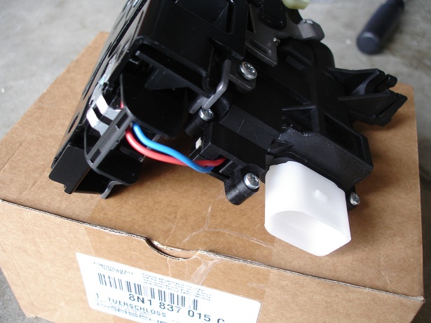

I just replaced my driver's side door locking mechanism Saturday. I did not have the same issue you are having but it did fix my problem (widow drop when door is open).
Here are a couple of photos of what the door locking mechanism looks like.
