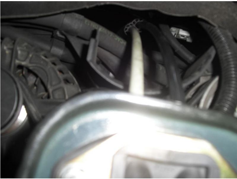

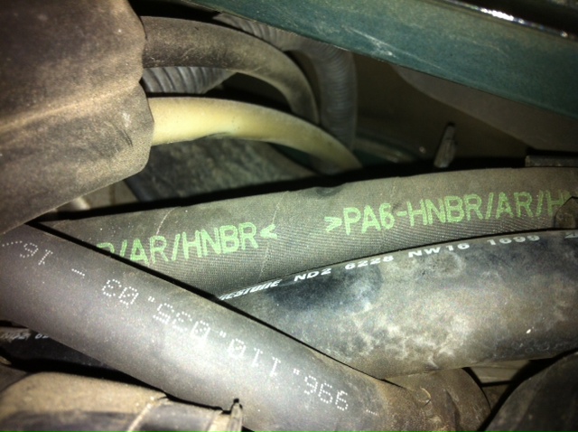

I was in my engine compartment and noticed this. I haven't had a close look at what the hose/line does but it appears to be an AC coolant line. Are these insulated with and inner sheath inside or am I in trouble right now? Looks like a B___ to change.....probably a firewall access thing. Is there an in situ repair solution that would hold for a bit?
Anyway wanted to advise all to check rubbing of their shifter cables on this line. I will have have to pad or tie up the cables somehow.

Thanks guys I will have a look...maybe I can rig up a schrader lock to drain the system....its getting cold and wintery here. I have to hurry if I am going to tackle this! Yeah coolant...I was thinking about a gas cooled....at the time.
I think my no. seven line is gouged

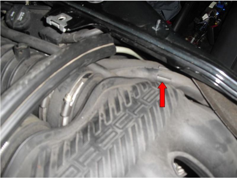

Hi jaykay.
I looked at my car tonight, and no signs of wear at all. In fact, the shifter cables are not even close to touching the AC lines. The only thing i can see happen, is the two lines rubbing agains each other, bet in my car they are secure with a plastic clip( or something like that). From looking at your pics again, it looks like the damaged line is misplaced. I took some pictures for you, and will post them in the morning.
I hope it will help you figure it out.

not the best pics, but this is the one showing the plastic clip/holder:
this one was taken from inside the car, with the firewall removed:
hope it helps.

Thanks. Yes shifter cables and lines are in different spots; maybe I can zip tie my cables away from the AC stuff.
