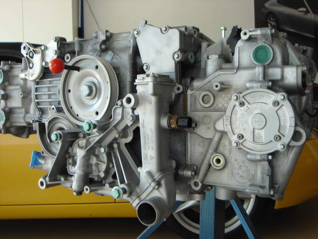

BYprodriver's Avatar
Location: O.C. CA
Posts: 3,709
Coolant temp sensor is on the coolant manifold side behind the drivers seat. Easy to replace thru the behind the seat access panel, although you need to catch escaping coolant while the sensor is out. Photo
Old 09-17-2012, 06:58 AM   #13
Join Date: Sep 2012
Location: UK
Posts: 8
its a bit tight to get to from under the car but i only had to push the wires back on I think if I have to change it at somepoint then BYprodriver's advice would be the way to go there is no way without taking all the bottom pannels off the car of getting to it easly cheers guys.
