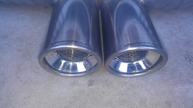

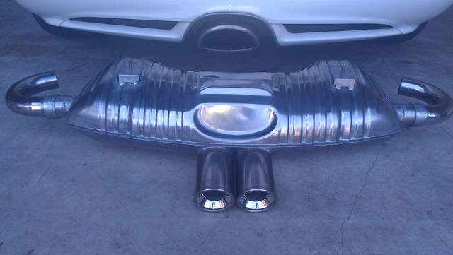

I just picked up a new (older style but never used) Gemballa muffler for my 2003 2.7 which I am hoping to install in the next few weeks.
I have searched around for pictures etc on removing the back bumper to get to the exhaust area but haven't really come up with anything. My Porsche service manager told me the best way to install it is to get the rear bumper off the car - I agree with him as it looks a bit too tight to do it with it on.
Does anyone have step-by-step pics? I tried Pelican's site with all the 'how -to' stuff but only found the one for removing a front bumper which was really easy.
Pics of the muffler attached.

I looks like one of M&M - Germany's exhausts made for Gemballa . Enjoy !
