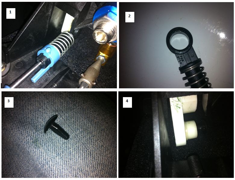

When installing the short shifter and the upgraded shift link, I manage (somehow) to release the other shift link (with the blue plastic part on pic 1) from the shaft (pic 4).
Trying to put it back in place is somehow puzzling. It will not lock on the shaft and can be remove very easily. There is a small black rivet on the center of the shaft, but it doesn’t look like it is looking anything (pic 3&4).
Am I missing an additional part here?
The shaft itself has a groove on one side of its surrounding. What side it is suppose to be facing?
Thanks in advance.

Hi Nobby, thank you for your response.
I guess I failed to explain myself.
As you can see at my pictures 2 & 4, instead of sliding the blue part and disconnecting the cable from the shift link, I disconnected the shift link from the shifter it self.
Now, when I put it back it doesn't lock on the shaft. I'm not sure if I need to use more force to lock it. The little rivet kind of throw me off. Usually a rivet like that will be used to lock or secure something, in this case it looks like it is just seating there.
Unless I'm missing a part, or I broke the linkage

I have my original shifter off of 01 box.
I was able to just push the clip out from the back side of the white block (left right motion of the stick) and then pushed it back in with light thumb pressure. it was relatively easy to take off and put back in. little spooky how easy the piece snapped in.
If the legs (don't know what to call it, your photo #3 ) are not broken, it just snaps in and is flush with the top surface of the white collar sleeve.
the attache photo shows the pieces
hope this helps

LOL!
Just fixed it half an hour ago.:dance: Wanted to update the post, and saw yours.
Thanks anyway sb01box. I'm sure your pictures will help someone in the future.
It could definitely help me if posted sooner. If you look at pic # 4 that I posted you can see that the white plastic part is installed on the shaft before the shift link, and the other way around (the lip is facing the inner part of the shaft). That's why the black rivet didn't lock anything.
What I did today, is exactly as shown in the picture you posted.
1.installed the shift link on the shaft.
2. Install the white part with the lip facing outside (that's the only way it will go on if you INSTALL THE SHIFT LINK FIRST!)
3. Place the rivet.
Done.
