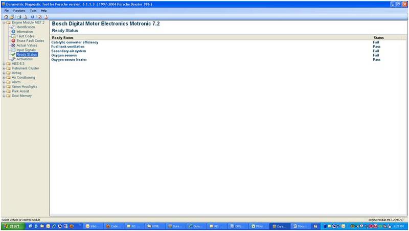

It did fail me on the readiness which I believe is what you could use to determine if you will pas the DMV inspection. Mine fails miserably. Some other faults are due tomthings that PO did. Replaced stock seats with sport and disconnected harness, did some hot wiring to alarm to do something with the radio etc. But the O2 sensors bother me. I did see the one by cylinder 4-6 was dripping with engine oil. Cleaned it but might have to replace after I change the coil tubes.

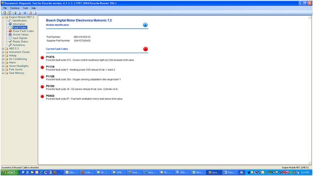

Below is the work log from the program. More to come later.
Bosch Digital Motor Electronics Motronic 7.2
Module Identification
Part Number 986.618.660.03
Supplier Part Number 004157026450
Current Fault Codes
P1576:
Porsche fault code 274 - Cruise control readiness light via CAN exceeds limit value
P1119:
Porsche fault code 5 - Heating power O2S ahead of cat. c. bank 2
P1128:
Porsche fault code 360 - Oxygen sensing adaptation idle range bank 1
P0150:
Porsche fault code 18 - O2 sensor ahead of cat. conv. Cylinder (4-6)
P0442:
Porsche fault code 97 - Fuel tank ventilation minor leak below limit value
ABS/PSM 5.3
Part Number 996.618.135.01
Supplier Part Number 02730041780246
Current Fault Codes
No Faults Found
Airbag B05
Part Number 996.618.219.01
Supplier Part Number B05
Current Fault Codes
3:
Supply voltage
73:
Child seat detection
1:
Airbag warning light
Automatic Air Conditioning H01
Part Number 996.653.101.03
Supplier Part Number 36
Current Fault Codes
20:
Combi-interface fault
21:
Ambient temperature sensor fault (intake duct)
22:
Instrument panel temperature sensor fault
23:
Footwell blow-off sensor fault
26:
Mixing flap motor fault
27:
Central flap motor fault
28:
Footwell defr. flaps motor fault
29:
Outs./recirc. air fl. mot. fault
31:
Fresh air blower fault
33:
Sun sensor fault
Alarm I32
Part Number 996.618.260.07
Supplier Part Number 080504003007
Current Fault Codes
49:
K lead
Status: not present
Occurance Counter: 3
This fault is displayed for informational purposes, it is not an indication of a problem and no repair is needed.
11:
Voltage failure during alarm output
Status: not present
Occurance Counter: 1
10:
Voltage failure at terminal 30 with alarm system active
Status: not present
Occurance Counter: 2
33:
Interior sensor faulty
Status: not present
60:
Central locking limit position Lock not reached
Status: not present
Occurance Counter: 9
Current Fault Codes
P1576:
P1119:
P1128:
P0150:
P0442:
ABS/PSM 5.3
Current Fault Codes
No Faults Found
ABS/PSM 5.3
Current Fault Codes
No Faults Found

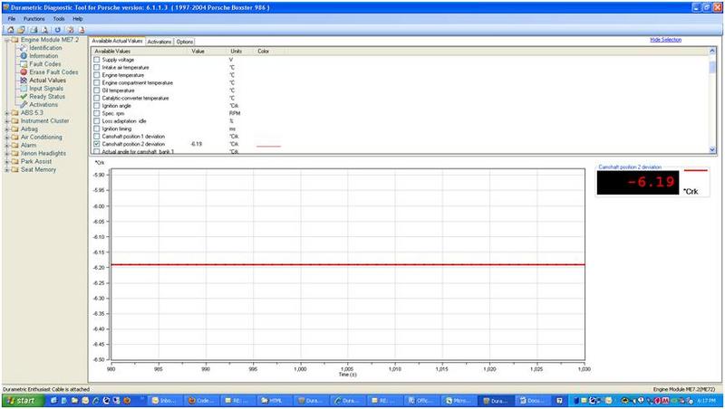

You did not preform the most important test
Under DME, check for camshaft deviation.
The reading will show you a value between 0 and -8.
The most important thing is to see that the value stay steady on idle. The graph will show a strait line.
That will confirm that the IMS is in a good shape. If the line go up and down, well... you have a problem.
Good luck

Would I do this while the car is idling or do I have to drive it around?

No need to drive it Bala.
Just let it idle and make sure the line stay steady.
This is what our dear friend JFP in PA posted as reply to my question in the same matter.

After a full day of wrestling with the new top, wanted to have some fun and got back on the code reader. Here are some screen shots. Does it look like my IMS is feeling good at the moment. Can I sleep peacefully for a few days?
Camshaft 1
Camshaft 2
Camshaft angle
And then I have these errors. Need to get my DMV inspection done. I have the Borla performance exhaust with the stock headers. PO said they would pass. Given these fault codes am I looking at a fail?

as for your IMSB
looks solid as a rock.

Camshaft deviation looks good but the value of cam 2, 6.3 is out of spec, should be +- 4. Check it again after the car is fully warmed, meaning after being driven for more than 1/2 hour and the radiators have cycled a couple of times. Cam 2 on mine varies between 5.3 and 6.X depending on temp. I'm not too worried about it being slightly out of spec as the car runs fine.

Found the cause for the "Cruise Control readiness light exceeds limit value" error code. The bulb for the CC light in the dash was missing. Taking from another and putting it in not only lit up the light but also cleared the fault.
