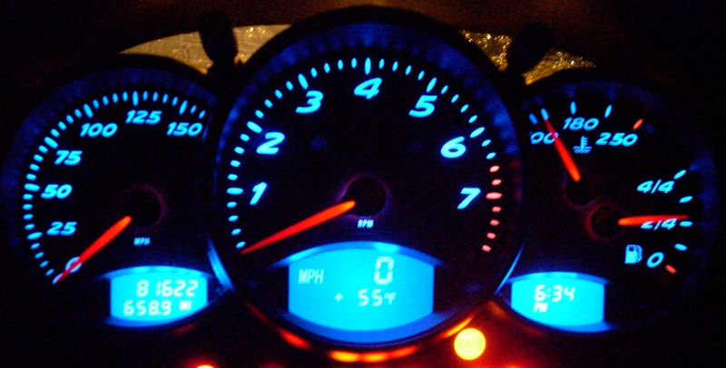

Drew, can you post a pic of your blue illuminated cluster? It would be nice to see what it looks like.
Old 11-29-2011, 02:44 PM   #8
stcroixdrew's Avatar
Join Date: Sep 2007
Location: Pennsylvania & US Virgin Islands
Posts: 59

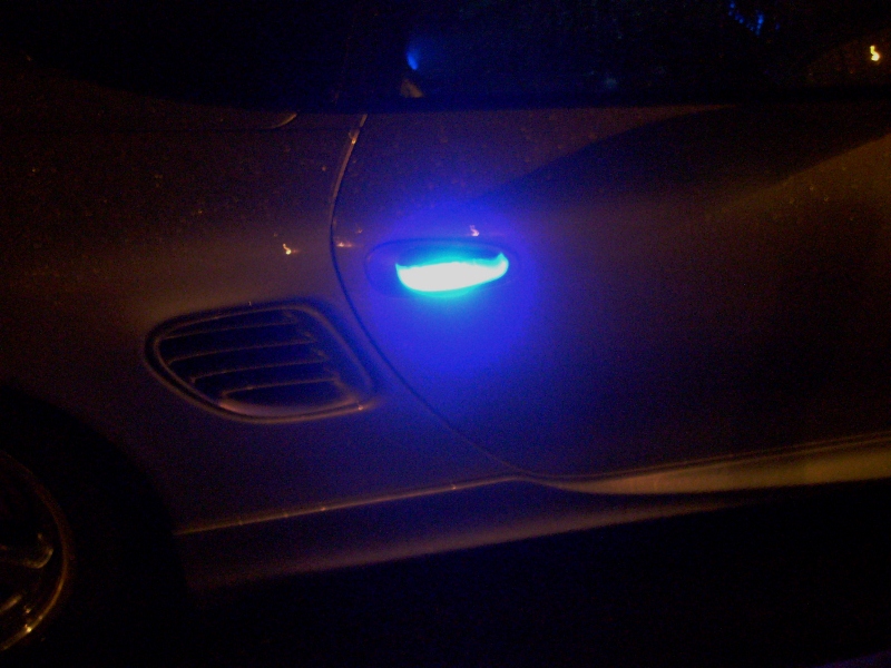

Blue as requested
Sorry for the slight blurrr...I ran out in the monsoon we are having here in Philly right now. Plus it matches my LED door handle Puddle lights I installed...

Wow. Those blue LED's make the stock lamps look pretty low rent. Thanks for getting the pics in the rain, much appreciated!
