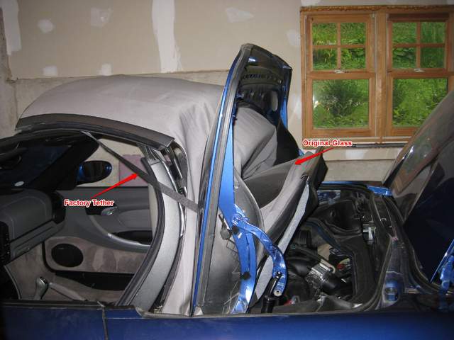

This is the factory top with a glass window in the extreme service position. The clamshell guides have been dicconnected to give me alittle more access to the engine bay. The angle of the window is what it is, I can't get it into the vertical any more than shown.
To work in the engine bay you are pretty much orientating yourself 45degrees to the car body, from back to front. To gain more engine access I could remove the top completely, then where do I store the top.
