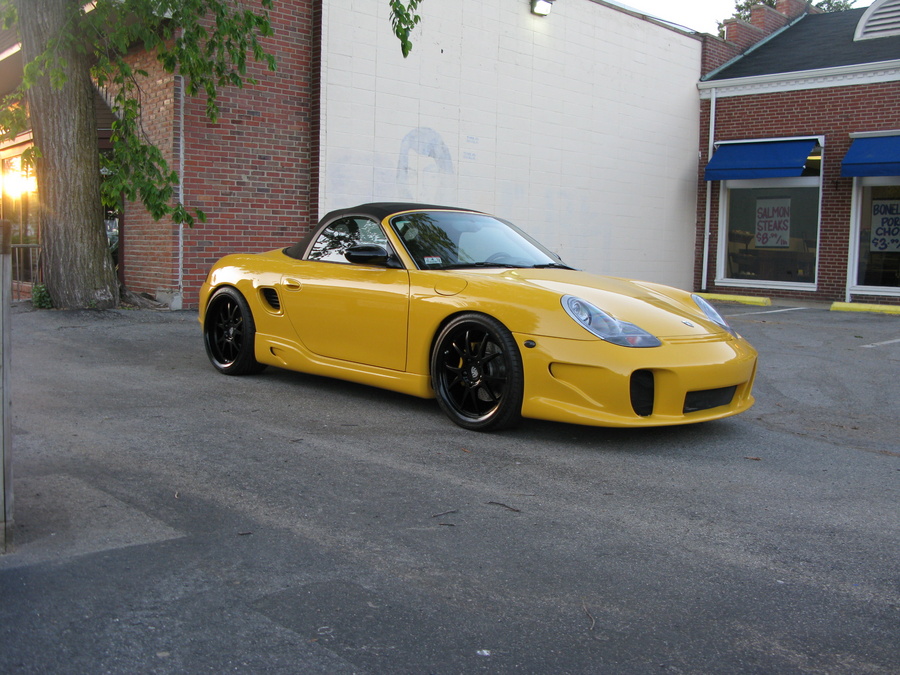

Does anyone know how wide of a rear tire I can put on my 97 non s wheels?

I think it is 9 inches stock.(not 100% on that) Keep it that way on the stock wheels.
You can get wider tires, up to 10 inches, if you get aftermarket wheels that are equally as wide.

People have definitely put 10" rears with 285s. Not sure on the exact offsets use. I have 9" rears with a very wide 265 on there and can see there is room for at least a 285, but I'm not sure how much more than that. Offsets are going to be the big factor, I do recall some specs out there somewhere that detail which 993/996 wheels you could use.
