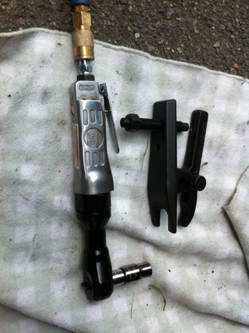

started my R.O.W. install today in 97 degree heat . enlisted my ricer brother inlaw (photo) . took the whole front apart in two hours including sway bar. no problems at all yet. i do not have my upper strut replacement parts yet but if i did anther 1.5 hours to put back together. the key is having tools and a second set of hands. Ball joint separator and the pneumatic wrench makes things go quick. pop the tie rod it makes removal a snap.
