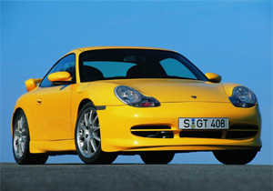

Depends on what you consider a "replacement"...factory 986 bumper covers will fit up to MY 2004 . Bumper covers from a 996 will fit up to MY 2001...after that, they changed headlight configuration. Lots of aftermarket choices, but fit and finish will be a PITA. 996 turbo, 987 and 997 will not fit.
Very popular upgrade is the MkI GT3 bumper cover...bolts right on and looks nice and not overly aggressive.
