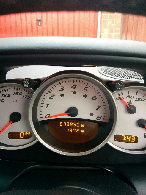

Upgrade from non-DOT Matrix to DOT matrix cluster?
I couldn't find much info on how easy it is to do this, but how easy is it to upgrade the boxster dials from a non-DOT matrix type to a DOT matrix type?
I don't want to upgrade to carrera dials or anything, just change from a Boxster S non-DOT matrix to a Boxster S DOT matrix style cluster.
Easy to do?
Porsche Boxster S Type 986

My mistake...I thought you had a 1999 for some reason. You can swap for a dot-matrix
There are 3 types of clusters for the 986 (to my knowledge).
1) Gen 1 clusters (1997-2000, not interchangeable with later clusters)
2) Gen 2, non dot-matrix (2000-2004)
3) Gen 2, dot matrix (2003-2004)
#'s 2 and 3 are interchangeable with each other, but not #1.
If your car came with OBC enabled from the factory and is 2003 or later, you get dot-matrix. If OBC was not enabled from the factory, you get standard gen 2 LCD.

Ah. I have the Gen 2 non DOT-matrix.
So I could potentially buy the stalks, wire them up to a set of DOT matrix clocks that came from a car with OBC enabled, and it would work?
Lovely!
What's the part number for S clocks that are DOT matrix?
Lovely!
Yes.
I'm not sure about the part #, but it's probably in the parts catalog.
http://986forum.com/forums/general-discussions/56530-986-parts-katalog-usa.html
Edit: there are tons of part numbers for the gauge clusters in the parts catalog and no indication of which is dot matrix. You may need to contact someone that has done it and ask them.

For anyone who's interested, the part number for the Boxster S DOT-matrix type is:
986.641.237.00 (for MPH)
And it's literally a case of un-plugging the old one and plugging this new one in? And everything would work perfectly? (Apart from mileage obviously)

Yes everything will work fine (water temp, fuel level, speed, voltage, oil level check, oil pressure light). You will need to change the oil pressure switch on the engine to get the gauge to work.
You may also need to have the VIN transferred into the new gauge stack if you have a stock radio otherwise you might have issues.
There are individuals here that can help you do that...for a price.
