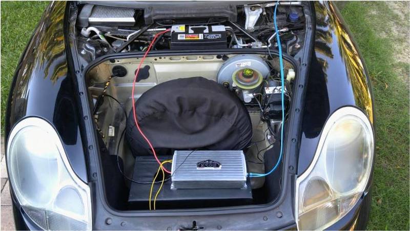

The new head unit is last years Lanzar SNV695B. 80 watts per channel, 4 channels, on sale for $189, I quite like it. A boss 2000W amp goes in the frunk to drive an Infinity 860W reference subwoofer in a band pass enclosure. The 200 watt amp will only drive 1000 watts due to the 860's impedance. Infinity 62.11i 6 1/2 inch speakers go into the doors and will be driven at 80W each. This should be plenty of volume and thump for a little Box.

I fired up the sub using my home stereo and almost took out the glass in my book case.

Where are you putting the sub? In the frunk? I don't think my wife would go for that That spot is reserved for her luggage in my car
Old 08-27-2015, 05:56 PM   #3
Since the frunk is sealed, are you planning to port to the cabin somehow?
If not, it's just going to rattle like crazy.

Unlike higher frequencies, low frequency sound passes through most materials fairly readily which is why aside from their size, subs end up in trunks. We've all experienced this at stop lights when we get to enjoy someone else's subs from the inside of their car to the inside of ours. What we miss in that case is all if the mid and high frequencies. Those have to be generated in the cabin. It's not optimal but I don't think that communication between the air in the trunk and the air in the cabin is critical for good performance, meaning the windows will still rattle at low frequencies. Having said all that there's bound to be a loss of performance so its a bit of a gamble. I'll report out after it's running and let the forum know how well it worked. As for luggage, I'm looking for a connector so I can put a handle on the sub and make it removable. Particlewave, any ideas on a connector? I was thinking a standard 3 prong might work, but it will look like something Jed Clampet came up with.

I must chime in to say skip the sub for a number of reasons;
1) There is no way it can effectively delivery bass to the cabin
2) That "2000watt" amp is more than likely less than 200 watts.
You can go ahead and TRY... but you will not like the results, and will have wasted your time.
Focus on getting what you can out of the door speakers.

False. You can effectively get base to the cabin. Not overwhelming BOOMING base - but a good base non-the-less. My old ride had the Bose surround system and had the sub mounted behind the seats where the cubby is. It delivered solid surround sound base. I can only imagine if you had hooked that up to a more effective amp, you would have some solid booms behind your head. The rear surround speakers also helped to fill the cabin with a nice sound.
Old 08-28-2015, 11:51 AM   #10
Yes, but he is talking about mounting a sub in front trunk which has no air flow to the cabin.
You'll get some sympathetic vibration frequencies through the metal of the car, but minimal sound/pressure waves.

Ok doubters 1, Jamesp 0. The verdict is in, Subs in the frunk aren't worth the effort. There goes my "low frequency sound waves" theory. Here is a pic of the test setup:
The result was the sub and amp combination worked very well together. It was impressive with the hood open. While it could be felt inside the car, it made little difference in the overall sound quality over the dash speakers alone and is not worth having in the car. The trunk latch was buzzing like mad (I think it would eventually wear out / break) and there was much more bass response outside the car than inside. I'm glad I didn't go to the trouble of making things pretty or running wires to the frunk, this would have been a disaster. As it is I got to do a little design and play with my table saw. Thanks P-wave for your comments, they drove me to test this before doing a full install. Back to the drawing board.
