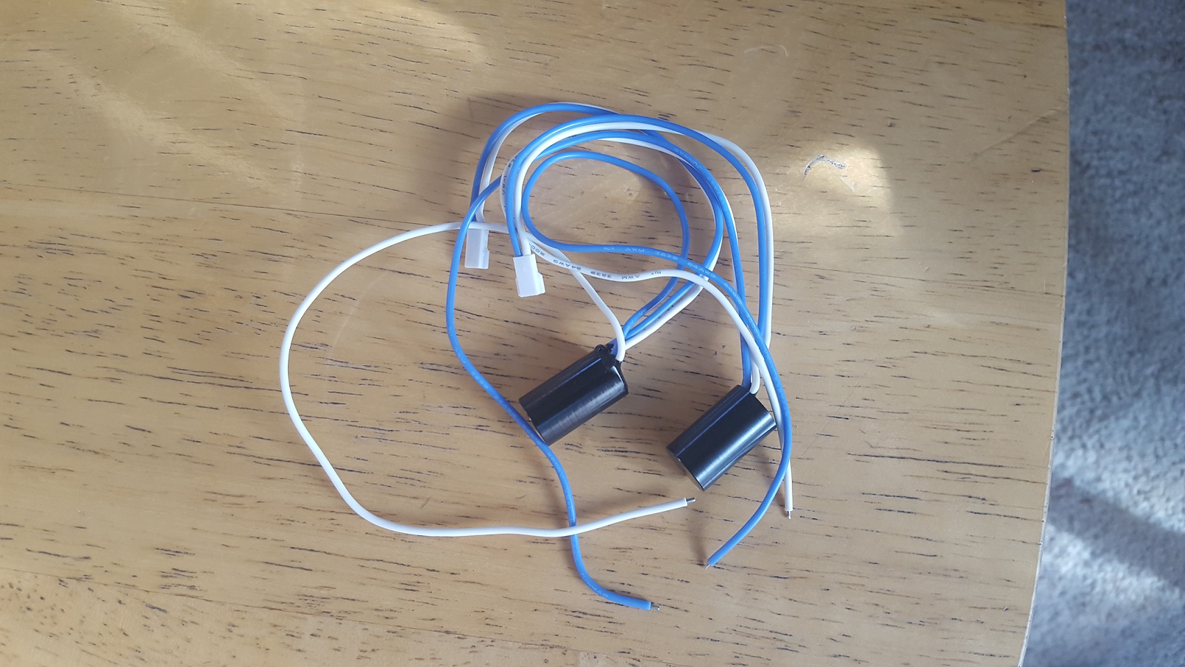

Last thing. These came with the kit:
Attachment 19657
I assume they go to the angel eyes, but what are they?

particlewave 08-30-2015 11:01 AM
Yes, you should clean thoroughly right before install. Debris inside from shipping is normal because they are not sealed units. There are 4 screws that hold the lens portion on the reflector.
The picture you posted shows the angel eye voltage regulators.

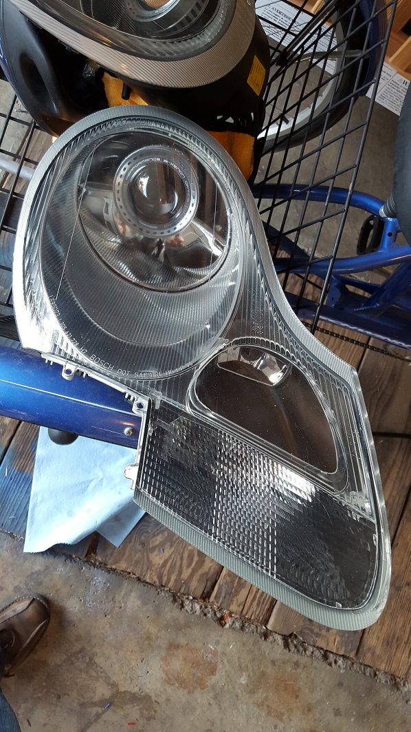

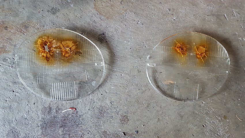

amagalla 09-09-2015 12:14 PM
2 Attachment(s)
These are the lenses that I started with.
Attachment 19685
There is actually a hole burned into the passenger lens.
This is where they are now:
Attachment 19686
The last steps are to clean the inside of the second drive side lens (passenger side done already) , seal the lenses, and polish the out side.

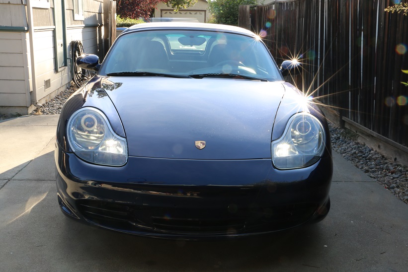

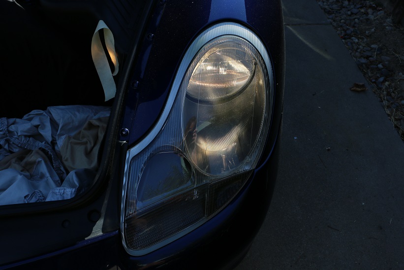

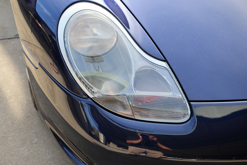

amagalla 09-16-2015 11:09 AM
5 Attachment(s)
I finally got all of the pieces in place to finish the headlight upgrade (was waiting for the corner pieces and the LED bright and fog lights). Here is what they looked like before:
Attachment 19733
Attachment 19734
Both headlights are in really good shape. But this looks so much better:
New
Attachment 19735
vs. Old
Attachment 19736
There is a notable difference in the headlight housing itself. If you look closely, you can see that there is a sort of diamond pattern on the inner shroud of the new headlight in front of and just below the projector. I mention this because if I had not bought these as a set, it's possible that you could end up with two different housings.
Here is a head on view:
Attachment 19737
Man, these look so cool.
Tony
