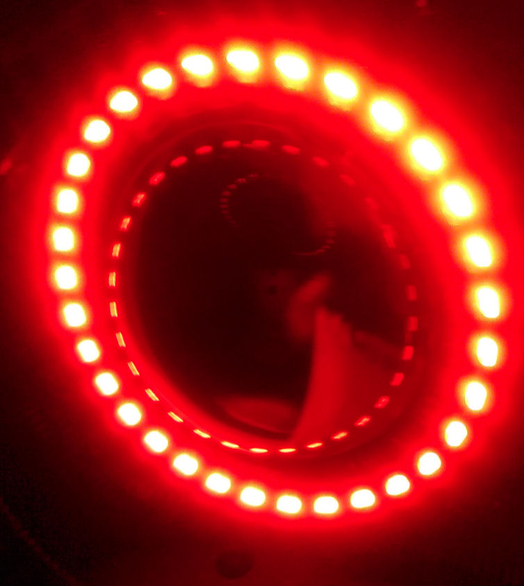

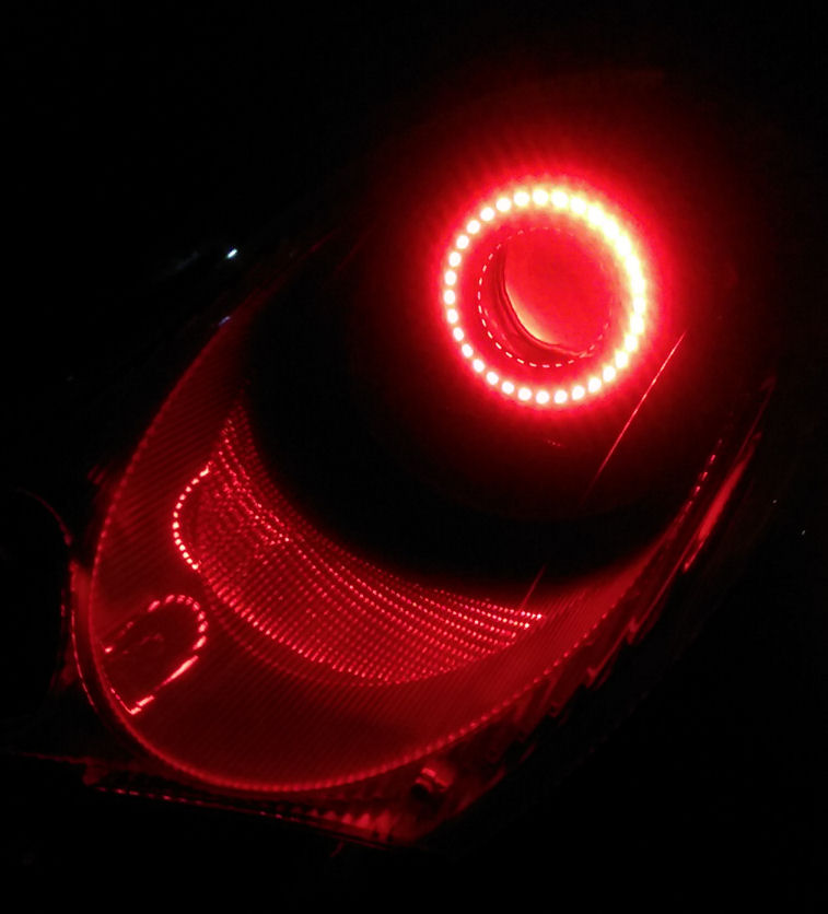

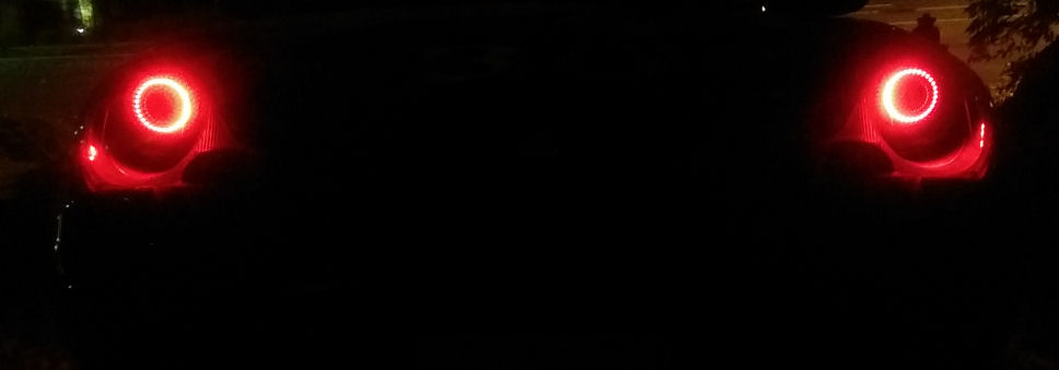

N0tt0N 11-06-2014 06:46 AM
Boo!
3 Attachment(s)
Originally Posted by particlewave (Post 422802)
Looking good, Bruce!!!
Now, time for some more car pron!
Turismo installed.
Happy Halloween! Thanks Fred! Thanks Charles!
Attachment 18917
Attachment 18918
Attachment 18919
Nine8Six 11-06-2014 08:46 AM
http://986forum.com/forums/attachmen...h-imag0740.jpg
Wicked stuff!!!
Use when young kids are in bed only. I can picture them calling on mommy if they see a Porsche car with evil eyes coming down their street
Thing's alive mouhahaha lol
Pdwight 11-06-2014 09:39 AM
Are the red halos legal in the US ?
particlewave 11-06-2014 09:58 AM
No, but who's counting? :p
They could be unplugged in the rear if it became a problem.
