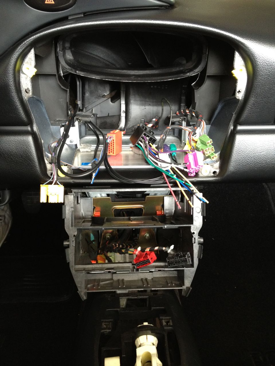

Originally Posted by jb92563 (Post 297918)
The speaker wires on the yellow plug will not work without the amp installed.
For those without an amp, there is supposedly a Brown connector to connect direct to the speakers, but I could not find that plug on mine to try it.
Also the sound going through the Equalizer can be customized to your taste if you have it (I mean EQ not Taste) may as well use it.
Where might that brown plug be hiding on a factory Amp install, hope they did not have a special wiring harness that omits it.
I also discovered that I apparently have 6 speakers, 2 dash, 2 door and 2 behind the seats. Seems like perhaps the Dash/Door are treated like a single Front and the rear behind the seat is the Rear speaker.
Also since I had the battery disconnected numerous times during the process things started working, like my car key locker flashes the tail lights twice as usual and gives the horn a short toot (Did not toot before)
You will probably find the speakers in the doors are subwoofers, I dont know if this is always the case though. Mine are connected to an alpine amplifier in the front.
Amazed you cant remove the equaliser, will make removing the alternator whine much harder.
The horn toots when you lock the car when the glovebox/armrest storage isn't closed properly.

Just to be clear, if you do not have an Amp there is supposedly a BROWN connector for the radio that goes directly to the speakers.
I could not find mine, but did not dig too hard to try and find it since the yellow connector goes to the speakers via the Amp anyway.
Do buy from a US reseller so you do not have the hassle to deal with extra shipping cost, 4+ weeks delivery time and import taxes.
Also make sure that it comes with Options that you want. ie Backup Camera (w/Night Vision)
TV antenna, GPS Antenna, GPS Software. Steering wheel controller.
As for the mounting rack I think I will be building one aircraft style with a 1/8" thick aluminum front plate and a tray attached to the back with flush rivets. The radio can then be screwed to the tray from the sides or bottom.
Everything will remove from the front as a single unit.
On top of that I will glue/velcro a plastic surround to match the car interior.
Pictures of course when I get that far but I am short on time to finish it up at the moment.
To attach the stereo wires to the existing connectors, since they are all female blade type I simply soldered and tinned the stereo wires, squeezed them flat with pliers and inserted them into the correct slot. There was no need to get any other connectors.
It worked fabulously as they are snug fit and make a solid connection.
Then I taped around the wires with black electrical tape so that they would not pull out when pushing the harness back.
I do want to try and locate a wire for the reverse signal so that the backup camera comes on automatically, but if it does not its no big deal. I'll just switch to it when I need it. If anyone knows where that wire might be give me a hint.
Also be sure to hook up the P_BRAKE wire on the stereo to ground so that the video can come on when you select it, otherwise it will not. (Safety feature so you can not watch Video while in motion)

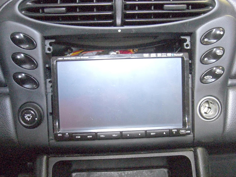

So without the install kit, you won't have that little plastic surrounding around your screen?
particlewave 07-18-2012 10:53 AM
Thats right...I may just make my own. Sheesh!
Crono0001 07-18-2012 11:06 AM
On the videos, it seems like the unit fits in pretty flush, save that opening up top. Are you sure we even need an install kit?

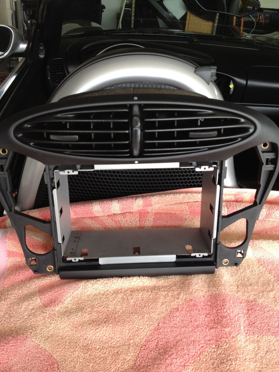

jb92563 07-18-2012 12:14 PM
When I put the plastic bezel on that the unit comes with there is maybe 1/16" on either side which is visually nothing.
However the top and potentially bottom will need something to cover it.
Thats where my 1/8" thick aluminum aircraft style surround will go and any plastic
will mount on that face.
The stereo will sit on an aluminum shelf inside, attached to the front plate.
The front Plate will have some counter sunk depressions for screws and the screws will be hidden by the plastic glued or velcro'd on top.
I departed from the typical Auto tray idea since there does not seem to be any good attach points.
However the upper Din Slot holes are intact and will make a good attach point and at the bottom the face can key in with the existing plastic and metal there without screws.

Yes, Plug and play for the speakers, power, Illumination(headlights on signal)
Power + (Yellow),Ground - (Black) , Illumination (Orange), Switched + (Red)

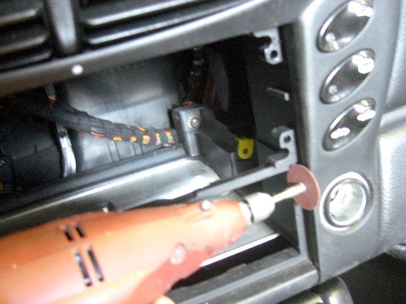

You cut midway through the middle mounting hole and tray seperator. Don't need to cut the top one.
https://lh6.googleusercontent.com/-K...0/CIMG3429.JPG

Here is the face plate I cut out of some 1/8" thick aluminum. The side wings will be bolted to the radio and then the whole thing as a unit fits into the opening.
There is a lip at the bottom that the bottom part keys into and the top will be secured by two screws into the existing two plastic screw holes.
https://lh3.googleusercontent.com/-7...0/CIMG3442.JPG
Here it is in the dash before the plastic trim that came with the radio.
A plastic surround will be cut to fit around the radio on top of the aluminum to finish the plastic work.
https://lh6.googleusercontent.com/-t...0/CIMG3443.JPG
Here is the radio with the included plastic trim. Still need to select and cut the plastic surround that goes on top of the aluminum. All that shows is a bit at the top and a very little bit at the bottom.
https://lh4.googleusercontent.com/-6...6/CIMG3444.JPG
