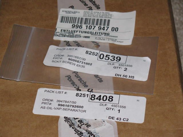

The parts were purchased through My local Porsche dealership. They have been giving me a discount so the tube from 4-6, 2 longer Socket HD Screws and the new AOS cost me $665 and change. If can figure out how to post pictures I have them. The sump extension from LN is on my tool Box. If time permits, this will be Sundays Project.

Parts Needed

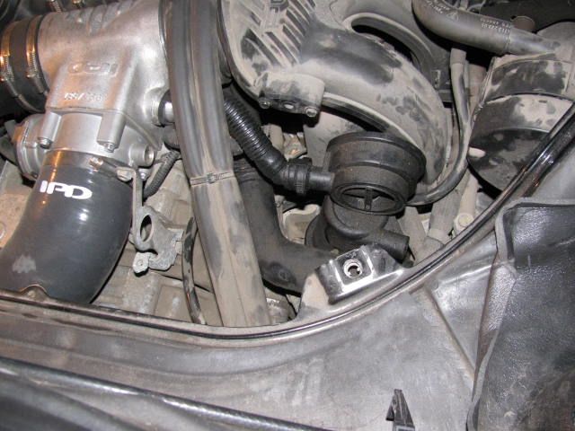

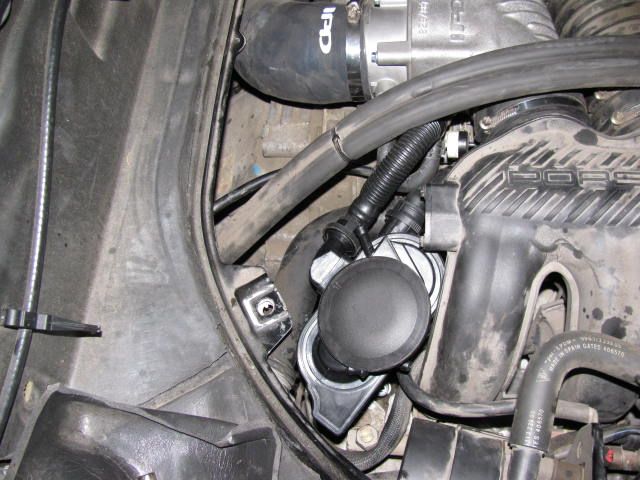

Difference in stock and Motorsport AOS
This the original AOS
Motorsport AOS Installed

Part numbers off tags
The old AOS
Actual new parts Breather tub 4-6 to AOS 2 6X25 socket hed screws and Motorsport AOS
Size difference between stock and Motorsport AOS
New one Installed
