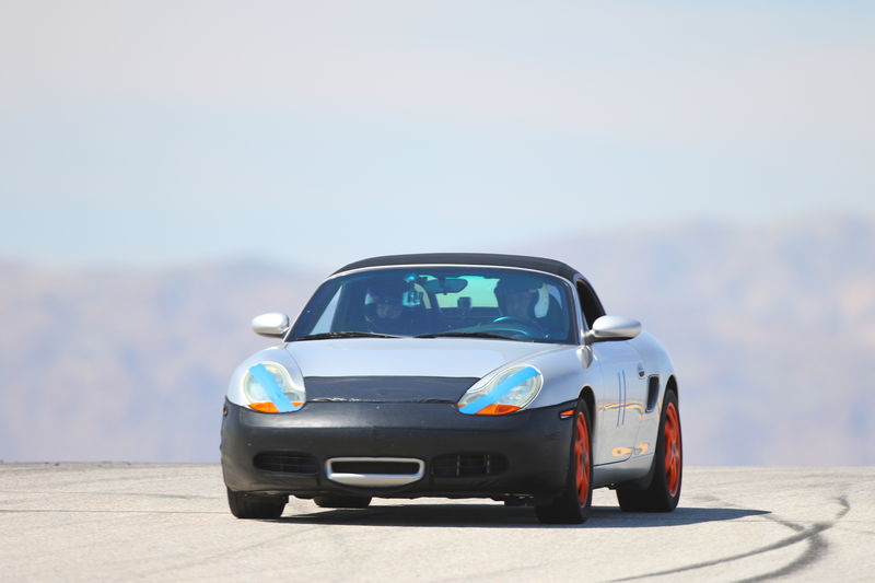

I have the exact same setup. I have 15 mm spacers all around and I keep them on permanently for my daily driver 18 in wheels, and for the 17 in track setup.
17 in wheels before and after 15 mm spacers:
You really need 15 mm in the front IMO. You could probably get away with 10 mm in the rear though.
