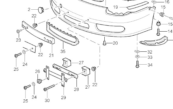

My 986 didn’t have a front plate when I bought it. I bought the mounting spacers from Pelican but I haven’t figured out what screws to use so they mount tightly. Any help?
Edit: With the help of AI I was able to determine the right screws. No thanks to PP’s search function or product description.

You will need a link to the PET, they list everything you need + spare part
number
24: B 4,2 X 9,5 sheet metal screw
30: B 4,2 X 32 Countersunk sheet metal screw
