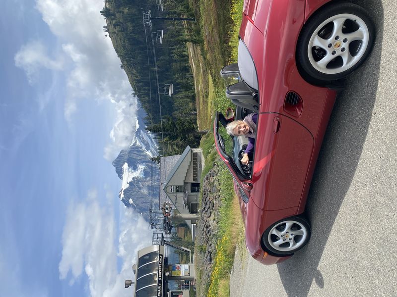

Wheels spacers or not?
Good Morning- I am considering adding spacers on my 01S. I have OEM 993 Turbo look wheels; fronts are 7.5x18 with 50" offset. Rears are 9x18 with 52" offset
Current tires are Continental Extreme Contact DWS all season. 225/40 on front and 265/35 on rear
Can anyone provide guidance on suggested spacer widths for front and back?
Also, for those who have added spacers to their cars, do you notice any change in driving characteristics and handling.
Thank you-
