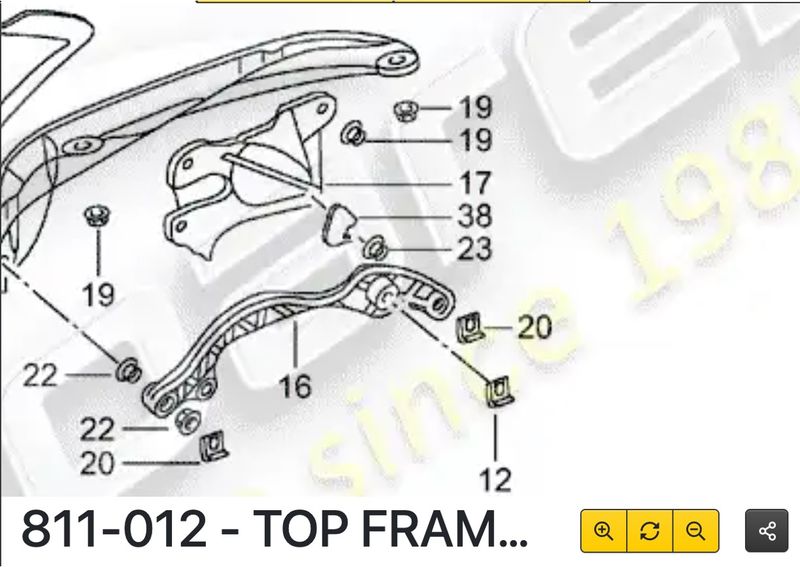

While poking around in the stow cavity for the top putting it all back together, I found this piece lying around near the support arm pivot pins on the opposite side from where everything went off the rails (Literally).
I searched all the various exploded diagrams for the convertible top sections for the 986 but can't seem to find anything that looks like this.
Does anyone know what this is, where it goes -- and whether it is essential, critical, important, or just nice to have (in a German OCD-ish kind of way)?

Never mind.
It's a spacer on the lower pivot pin for the tonneau cover arm.
Found it in both a diagram and on the car (the one (on the side that didn't pop out).
It's 38 in the picture below.

i think its main purpose is to hold that foam insert for that area in place.
this is the foam barrier that directs all water to the drain hole.

Connection piece
I've got the part if needed...
98656165700 Connection Piece

WOW! I can't speak for anyone else, but I probably wouldn't have identified it from that grade-school-style drawing of it. I looks nothing like the actual piece!
Good thing you found its twin on the other side.
