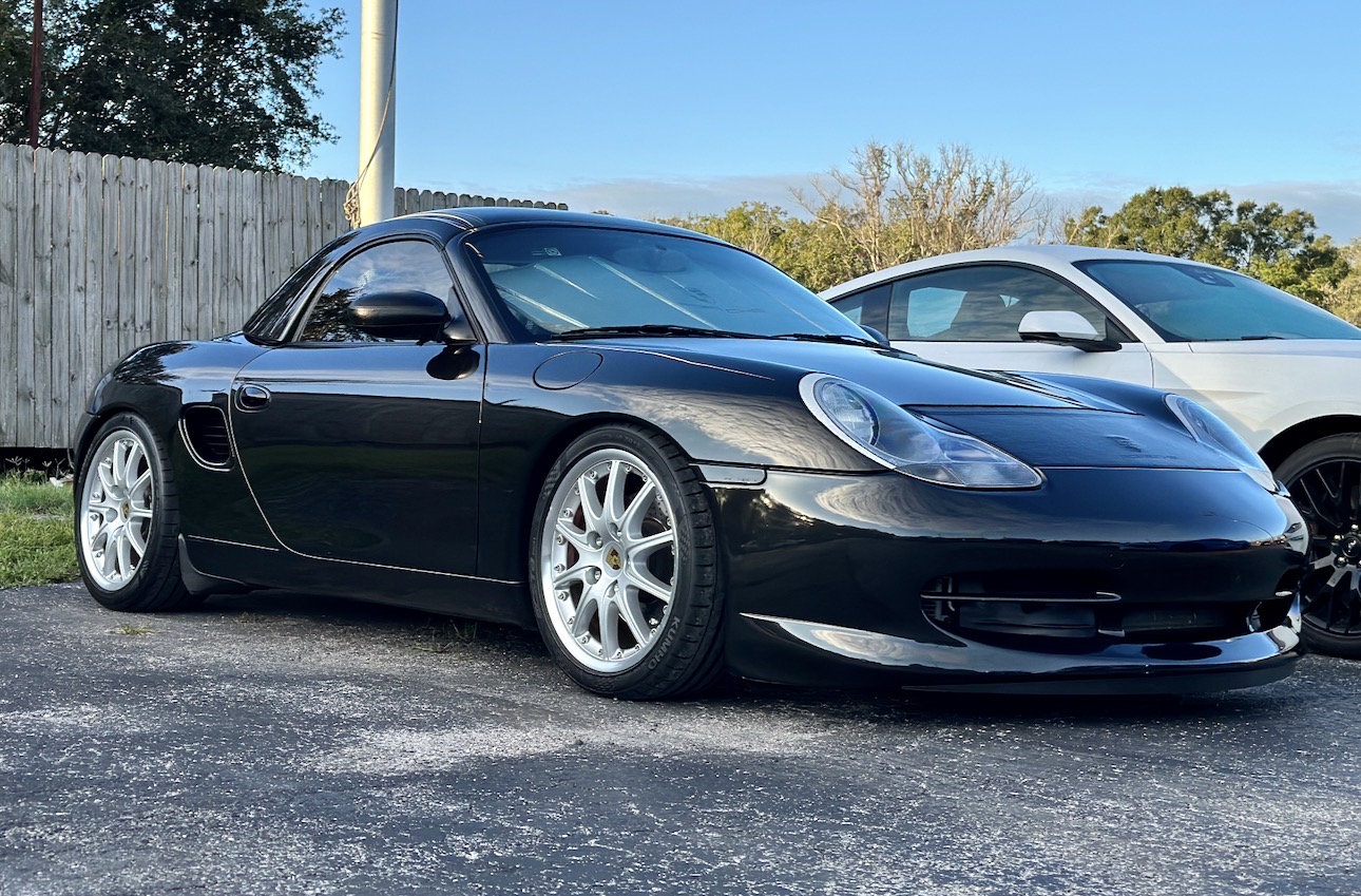

I'm currently running Vogtland springs with the original OEM shocks. The ride quality is much smoother compared to the OEM springs and the handling is has improved as well. I've had H&R and Eibachs springs before and I have to say Vogtland has the best ride quality overall.

Vogtland is definitely much more comfortable than H&R. When I had H&R springs they were very bouncy and stiff. Vogtland does also lower both the front and rear 1.2".
