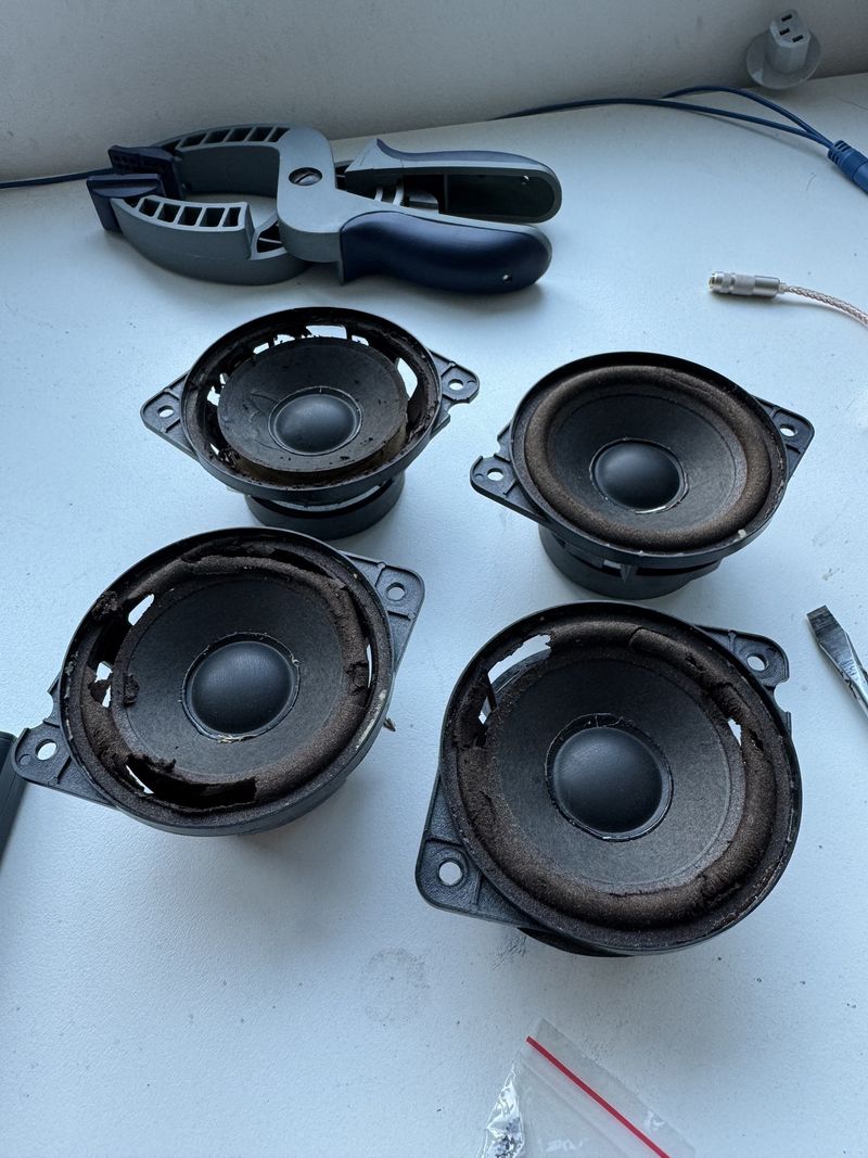

Anyway, over the years the speaker foams have deteriorated on all 4 rears and they started crackling when turned up. So it's time to replace them.

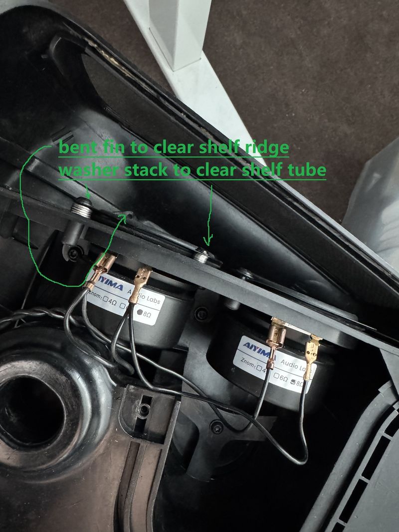

1. The OEM speakers were 6 ohms each, 2 pairs of 2 in parallel - making each side 3 ohms. Not the 8 ohm to 4 ohm arrangement I had assumed.
2. I bought Ayima branded speakers from Aliexpress, 3 inch, 8 ohm, with square bezel. $100 AUD for 4.
3. One "tab" of the square bezel needed to be bent to fit the shelf housing - this will be obvious when you try fitting it.
4. One speaker from each side needed to be lifted by around 5mm to clear the shelf fitment tubing. I achieved this with washer paddings.

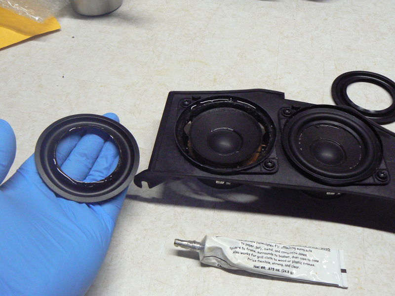

My rear shelf speakers had deteriorated just like yours, but I chose to repair rather than replace them. Removing the broken-down foam speaker surrounds and installing (hopefully) more durable rubber replacements was a fun project and now the original speakers work as new.
More on my speaker restoration here - https://rx19jones.wixsite.com/a-986-s/2024
