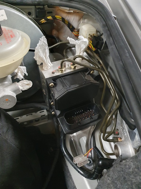

So, forward with the hardware swap, some nice steps made there.
This is the ABS 5.3 unit still in the car;

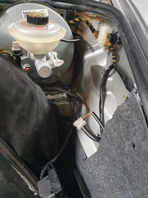

Then, taken out (along with bulkhead feedthrough block as I need one with the additional rear line)
And the ABS 5.7 in the car (not screwed down, so it is still tilted a bit)

With all the stuff out of the way it is also time to think about the position for the power steering pump. Basically there are two options, each with pros and cons. I would welcome some feedback and / or alternative ideas.
1. Mount it in the frunk:
+ easily accessible
+ close to wiring options
+ 3rd radiator option remains open
- takes space away from the frunk. Might not be the most visually appealing.
- might mean I can't mount the spare wheel anymore
2. Mount it at the front, behind the bumper cover
+ seems like plenty space there
+ easy hose routing to the rack
- longer electrical wiring, but still ok I guess
- not accessible to fill it up (although I can't recall the last time I had to top up power steering fluid..)
- no more option to add third radiator
On the aesthetics of option 1 I was thinking of getting myself a brake reservoir cover from a RHD vehicle. That might work out nicely.
